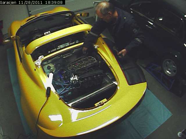

I går kveld fikk jeg unna disse punktene:
'Stemningsbilde':
...så i dag kommer vel toppen av tenker jeg...- remove the inlet plenum (this is held by 7 bolts/nuts I think. 4 bolts underneath that are near impossible to see and 3 nuts/studs on top that are a little easier to see. You can leave the fuel pipes connected.)
- remove the exhaust manifold (the 'top' nuts are usually OK to get to but the 'bottom' ones can be a pain. There's 5 'top' ones and 3 'bottom' ones from memory) - det var 5 bolter totalt
- remove driver's side rear wheel
- remove driver's side rear wheelarch liner (a complete b@stard of a job. Expect this to take forever!) - tøys og tull, enkelt
- remove the front part of the upper timing belt cover (several small bolts and from memory there one 'behind' the water pump that you can't see)
- rotate engine using crank pulley until the cam pulley marks are level (this should also mean the crank pulley mark is aligned with its mark. And as DVA pointed out to me the cam pulley marks don't have to the 'right way up' as long they're aligned its fine)
- insert cam pulley locking tool

Som sagt så gjort:
Umulig å se om noe er galt egentlig, men ventilene i den ene sylinderen er mistenkelig mye renere enn de andre:
Noen som kan se noe rart forøvrig?
Med andre ord er toppen av Tusen takk til Inge som dermed er re-sertifisert som Lotusmekaniker.- loosen cam belt tensioner (large-ish allen-headed bolt and small hex headed bolt). The allen-headed bolt will probably be extremely tight so use a good quality tool.
- loosen (but don't remove) cam pulley bolts and cam pulleys
- move cam belt as far out of the way as possible
- gradually loosen the head bolts (working in a spiral towards the centre I think - best to check the manual for the recommended order). These will be extremely tight! And you'll need to move the cams slightly to get to some of the bolts.
- remove the head bolts once they're all loose and place into a piece of cardboard to retain the order - evt kast dem
- remove cam pulley bolts and cam pulleys
- remove rear part of upper timing belt cover - ikke nødvendig, bare flytt det ut av veien for toppen
- lift off the head with as assistant (placing it into a cut down cardboard box inside a bin bag with some newspaper in the bottom ensuring the valves are facing up)
